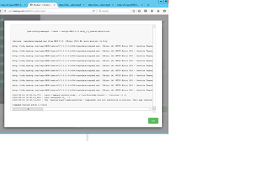

Following failed at installing this service:
Timeline Service V1.5 Install
failure: repodata/repomd.xml from HDP-3.0: [Errno 256] No more mirrors to try.
http://ufm.hadoop.com/repo/HDP/centos7/3.0.0.0-1634/repodata/repomd.xml: [Errno 14] HTTP Error 503 - Service Unavailable
2018-09-18 16:05:51,775 - call[('ambari-python-wrap', u'/usr/bin/hdp-select', 'versions')] {}
2018-09-18 16:05:51,805 - call returned (0, '')
2018-09-18 16:05:51,805 - The 'hadoop-yarn-timelineserver' component did not advertise a version. This may indicate a problem with the component packaging.
Command failed after 1 tries
