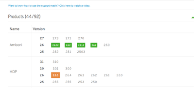

but from ( https://supportmatrix.hortonworks.com/ )
we can see that HDP - 2.6.5 can be installed on ambari 2.6.1 ( means that no need to upgrade to ambari 2.6.2.2 )

Both are correct (Supportmatrix and the Docs)
1. Supportmatrix is correct. Means you can run HDP 2.6.5 with Ambari 2.6.1/ 2.6.1.5 /2.6.2.0 / 2.6.2.2
