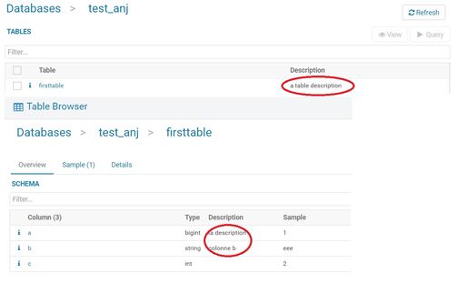

On Hue, I'm using the "Table Browser" that displays the table/column descriptions correctly and here is a screenshot:

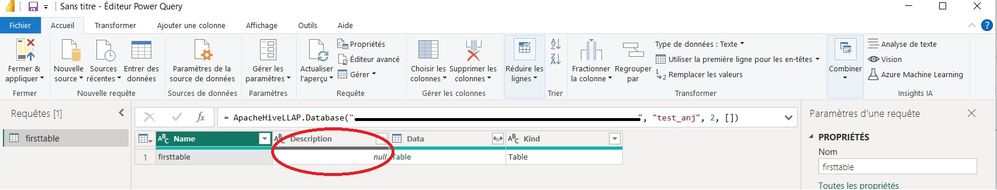

And here is a Power BI Query editor screenshot, where the table Description field is "null":

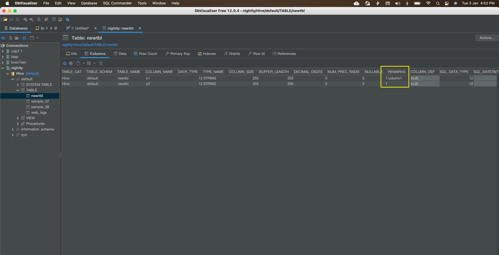

@anjel Power BI does not have a native Hive connector. I guess you could only connect using an ODBC connector. I just tried listing a table using DbVisualizer, and and it shows the column comments as REMARKS
So, I would say it is specific to the Hive client(Power BI)
