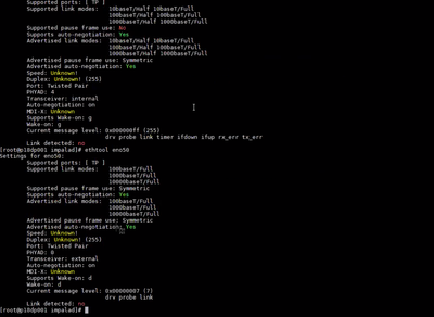

Example of "Unknown" is :
So you have to fix this at network level or you can suppress the Alerts if you think networking is good.
