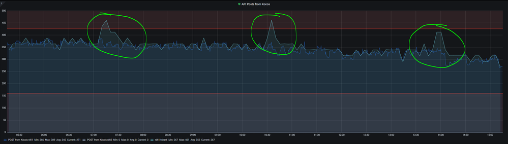

In the below graph we are plotting the flowfiles coming out of the httphandlerequest processor (dark blue) and also plotting a count of the captured posts from tshark every 5 minutes.
There are events where we seem to be picking up more posts in tshark than in Nifi (highlighted in green below).

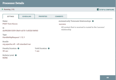

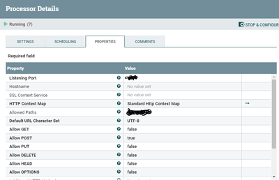

This is how our processor is set up:

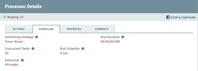

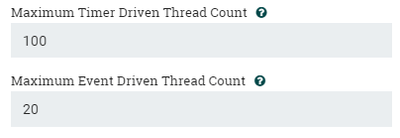

The settings I changed are both the thread counts below and the  concurrent tasks for the processor.
We expect about 5000 datapoints over 2 minutes,  currently scaled down to about 250 per 5 minutes - which seems like Nifi should be able to handle easily.
