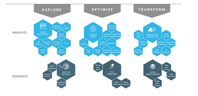

@atul kumar
You are looking for this http://hortonworks.com/solutions/
You will use Big Data tool sets to innovate and renovate.
Innovation is "make changes in something established"
Renovation is "process of improving an outdated structure."
