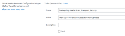

2. For MapReduce -> I enabled HTTS on MapReduce Shuffle with:
but I still don't understand where I should add the HSTS header configuration. In ssl-server.xml? How would the config look like? Like in the image bellow?
I tested with what I stated in the images above and HSTS header is not present.
Thank you!
