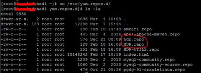

@Artem Ervits It says it is listed twice but when I show the list I only see one instance of the UTILS.repo file. I see two hdp.repo file. Would that be what it's referring to?

Go through every file and make sure there are no dups
