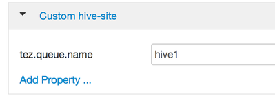

Add tez.queue.name to your custom hiveserver2-site in Ambari and restart hiveserver2, it will make your default queue.
You can also specify the queue when you connect or before submitting your query:
jdbc:hive2://localhost:10000?tez.queue.name=hive2
or
set tez.queue.name=hive2;

I followed all the instructions above. But it doesn't work.

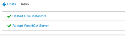

1) After change the session config, Ambari won't restart HS2. It only restarts metastore and webhcat. I had to restart HS2 separately.

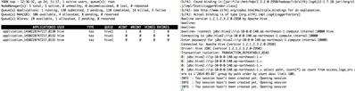

3) Initialized Tez session won't be used. Submitting query from beeline would try to start a new Tez session in the queue but it gets pended again.
About #2 I had similar issues with new sessions being stuck with ACCEPTED status in yarn ui for a recently created queue. It happened twice, I'm trying to reproduce it, but seems to be a capacity scheduler issue that you can fix restarting resource manager. After fixing this capacity scheduler issue, default queues and session per queue works fine. Notice that hiveserver2 starts session one-by-one, it may take a while to initialize them all.
About #3, I see the same. I will open a support ticket to get engineering on it. I found few old internal jiras related to this, but not with 2.3.2

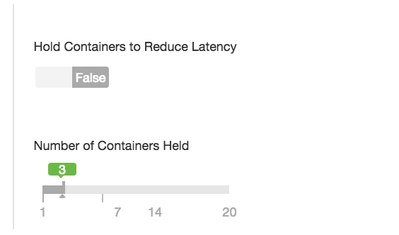

***** seperating out the thread to test prewarm container ***
@yjiang Change this for prewarm containers
Expert Contributor
Thanks, @Neeraj Sabharwal . I think this prewarm is a little different from the issue I found, which I think is Tez session (AM) initialization and queue config issue. Are they related or depending on?
Master Mentor
@yjiang Its diff from the original question but then you raised this "it can only start 1 Tez session since the old 1 session per queue config seems to be still effective."
