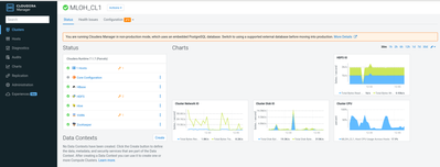

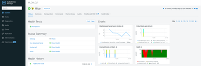

Hi there!
I have set up Hive and added Hive Server 2 in Cloudera Manager Trial version in order to connect with beeline.
Both are in green status but neither port 10000 nor 10002 are listening.
The message I get from beeline is "Failed to connect to <HOST>:10000
Could not open connection to the HS2 server. Please check the server URI and if the URI is correct, then ask the administrator to check the server status.
Error: Could not open client transport with JDBC Uri: jdbc:hive2://<HOST>:10000/: java.net.ConnectException: Connection refused (Connection refused) (state=08S01,code=0)"
