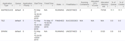

New Member
HI @dbompart
Yes the logic you mentioned is perfectly
I have some more clarification regarding containers on Map Reduce and Spark
In Map Reduce running sqoop Import
In Spark running PySpark shell on top of yarn
Now the configuration :
MapReduce:-
yarn.scheduler.maximum-allocation-MB :- 36864 * 2 = 73728
But my concern is now how can i limit the Running containers per user basics (I cant set Different queues in capacitor scheduler as mentioned above)
-> When ever i am running spark application is also running on top of yarn
Running Containers :- 3
Allocated CPU's :- 3
Total Memory allocated :- 5120
Will you help me the logic what is happening behind these
