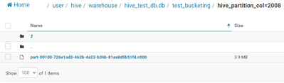

  • Spark can create the bucketed table in Hive with no issues.
  • Spark inserted the data into the table, but it totally ignored the fact that the table is bucketed. So when I open a partition, I see only 1 file.
When inserting, we should set hive.enforce.bucketing = true, not false. And you will face the following error in Spark logs.
org.apache.spark.sql.AnalysisException: Output Hive table `hive_test_db`.`test_bucketing` is bucketed but Spark currently does NOT populate bucketed output which is compatible with Hive.;
This means that Spark doesn't support insertion into bucketed Hive tables.
The first answer in this Stackoverflow question, explains that what @ssubhas  suggested is a workaround that doesn't guarantee bucketing.
