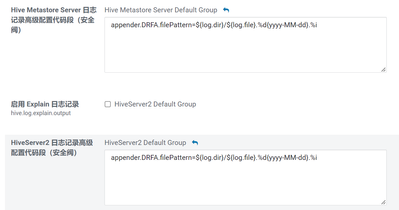

seems not working in CDH 6.2, this solution will cause hive2 restart failed. with <No type attribute provided for component rollingPolicy>

it should be like this, appender.DRFA.filePattern=${log.dir}/${log.file}.%d{yyyy-MM-dd}.%i
and it will be working in CDH 6.2
