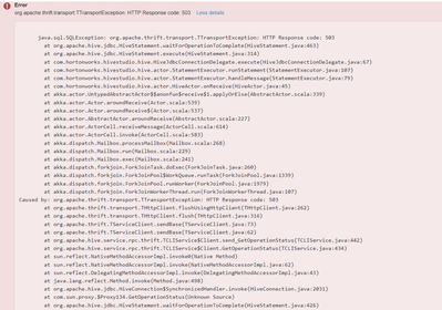

I have a default database catalog in Cloudera Data Warehouse(CDW) for a environment and I have created a virtual warehouse with that database catalog. I am trying to use a newly created UDF with this virtual warehouse. But whenever I execute that UDF I get the following error.

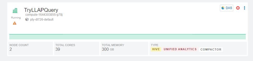

When I looked over at virtual warehouse there comes a alert symbol, on hovering which I get a message saying "Hive server service is not ready. Service endpoint may not be reachable!"

So my question is what could be the issue here causing core dump or can there be possibly different reason for hiveserver not starting. And is there a way I can get the core dump present at /tmp/hs_err_pid1.log location to analyze?
