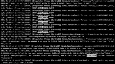

I'd like to add more information after some dig into the logs. I found some debug log below with INPUT_READ_ERROR_EVENT triggered (from log file: syslog_dag_1610695610027_0484_1):
It's from a similar sql with some aggregation, but raised the same error from hive shell.
It looks when the Reducer was trying to read from the result of the Mapper, some error occurred and the data cannot be passed from Mapper to Reducer.
The question still remains: why the sql (in tez) succeeds for hive user, but failed for other users?

From the log, we can see some INPUT_READ_ERROR, the error is raised by some downstream task complaining that it cannot get data from the upstream task.
The reason behind it is that when the downstream task try to get upstream task data from shuffle service (which runs on yarn node manager as an aux-service), a lot of HTTP 500 error raised.
Why shuffle service raises 500? It's because it checks the permission (owner) of data file sent out by upstream task and found the user name does not match, so it raised an error.
