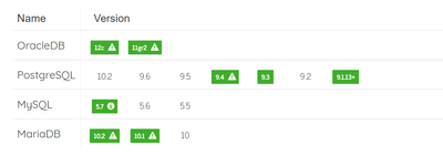

The below error tells me 2 things you are either using a MySQL server which is not supported or your jdbc driver version is not correct can you validate your Mysql database against the HXW support matrix

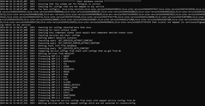

The attached /var/log/ambari-server/ambari-server-check-database.log shows you are trying to connect to postgres which is the embedded database.
My guess is your ambari Server is using the embedded postgres database and NOT MySQL so what you need to do after installing and configuring MySQL and Hive is

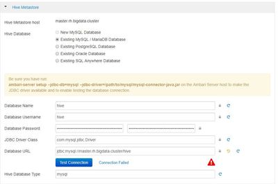

I tried with the "an existing Mysql database" but still have the same error, i also tried with the ip address and the localhost in the URL of the database but still nothing! here a screenshot of my conf

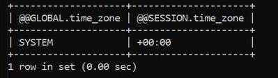

mysql and systeme time : 107943-time-mysql.jpg

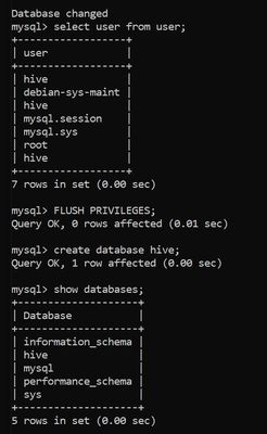

user and database on mysql :

I found this warning on /var/log/ambari-server/ambari-server-check-database.log :

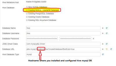

You have done everything correctly but you are not selecting the existing database you created See attached screenshot all should work !!!
Please use the values of the hive DB created previously it should pick the correct URL and host !!
