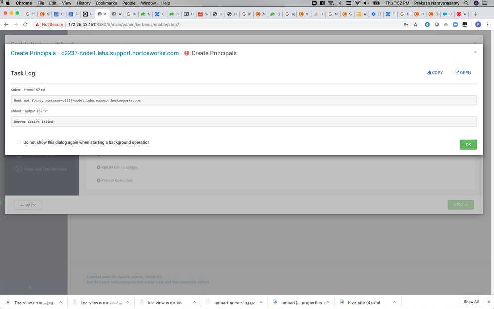

Expert Contributor
@jsensharma This issue has been observed in the internal lab cluster as well.
curl -H "X-Requested-By: ambari" -u admin:pnarayanasamy"http://c2237-node1.labs.support.hortonworks.com:8080/api/v1/clusters/c2237/hosts"
ambari server & kdc host c2237-node1.labs.support.hortonworks.com is not listed in the items array response.
/etc/hosts having only one fqdn for all the ip's.
