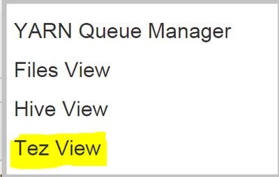

1.Click on Tez View underneath Hive View button will display the execution time for job.

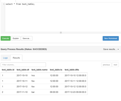

1.By using Ambari Hive View won't display the execution time of the query.

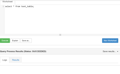

Hive View Execution:-
Logs Tab Hive View:-
If you click on Logs tab also there is no logs for the query.
It is impossible compare the time taken for select query to execute, because for select queries there is no map reduce job is going to be initialized, if application id is not created then we cannot compare them programatically.
2.Another way to get at least the execution times for select query is running from hive from command line(not from ambari hive view)
Open Hive from command line and execute the select query.
Once select query finishes at bottom of the results hive shows how many rows has been selected with the response time will be displayed.
Example:-
hive# select * from text_table;
| text_table.id  | text_table.dt  | text_table.name  | text_table.ts  |    text_table.dtts     |
| 1              | 2017-10-10     | hcc              | 12:00:00       | 2017-10-10 12:00:00.0  |
| 1              | 2017-10-11     | foo              | 12:00:00       | 2017-10-11 12:00:00.0  |
| 1              | 2017-10-12     | foo              | 12:00:00       | 2017-10-12 12:00:00.0  |
| 2              | 2017-11-10     | bar              | 09:00:00       | 2017-12-23 09:00:00.0  |
4 rows selected (0.105 seconds)
Scroll down to the last line in the above snippet and you can view that 4 rows and execution time is 0.105 seconds.
If you are running from Hive from command line hive displays how many rows are displayed and what is the execution time for the query as a last line in results.
If you are using Ambari Hive View won't display these stats also.
Only way to compare results of select query is Execute your select from Hive command lines and compare them manually.
