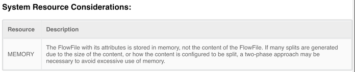

FlowFile Metadata/attributes are held in NiFi Heap memory. For queued FlowFiles, there is a configurable swap threshold in the nifi.properties that will swap batches of 10,000 FlowFIle's worth for metadata/attributes to disk when the threshold is met. This swapping is there to minimize excessive heap usage when queues grow large. The NiFi Content is not held in heap memory; however, some processor may need to read the content into heap memory for the processor to perform it's function. You will notice if you look at the individual components documentation that a "System Resource Considerations" section exists. If Heap memory usage is a concern for that processor, it will be documented there.
SplitContent processor docs example:
Processors like SplitContent will hold the all the FlowFile metadata/attributes (not content) for every split FlowFIle being produced in heap memory until all the output FlowFiles have been produced and committed to the downstream connection. These FlowFiles being produced can not be swapped to disk until they committed to the downstream connection. So if a splitContent were to produce 50,000 split FlowFiles, the attributes for all 50,000 would be held in heap. After committed to the downstream connection. 40,000 of those would get swapped to disk based on default swap thresholds. So heap impact would spike but not persist.
