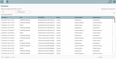

Here is my View Data Provenance (UI) the latest records shows on the top.AllIsWell_0-1747981128675.png

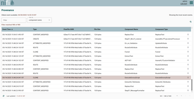

But it fetches the random data as attached UI screenshot of provenance data:
I tried with all combinations of reverse=False but no luck, if someone already tried and got the success result please let me know where I made the wrong or anything that i missed out here.
