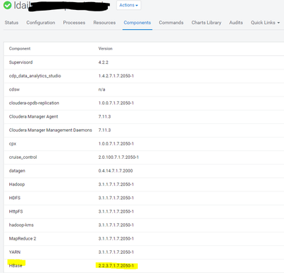

Another way without running the Host Inspector would be to go to one of the Hosts that run the service in question (here HBase), either from the Hosts view or from the Service -> Instance view, and than click on "Components".
It will show you all components running on that specific host with their corresponding version.

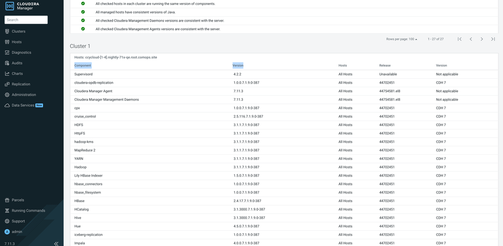

Hello @MaraWang
You can check component version via Host Inspector Results.
Goto Cloudera Manager > Hosts > All Hosts > Inspect Hosts in Cluster(from right top)  > Show Inspector results > Scroll to the Cluster name and you will be able to view the list of components and their respective version.
Attaching sample screenshot.

Cloudera Employee
Regards,
Sascha
Contributor
It works! Thanks!
