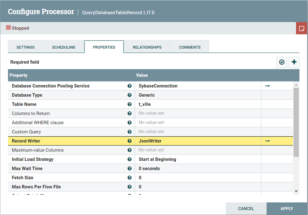

I'm using the QueryDatabaseTableRecord processor with the following properties:

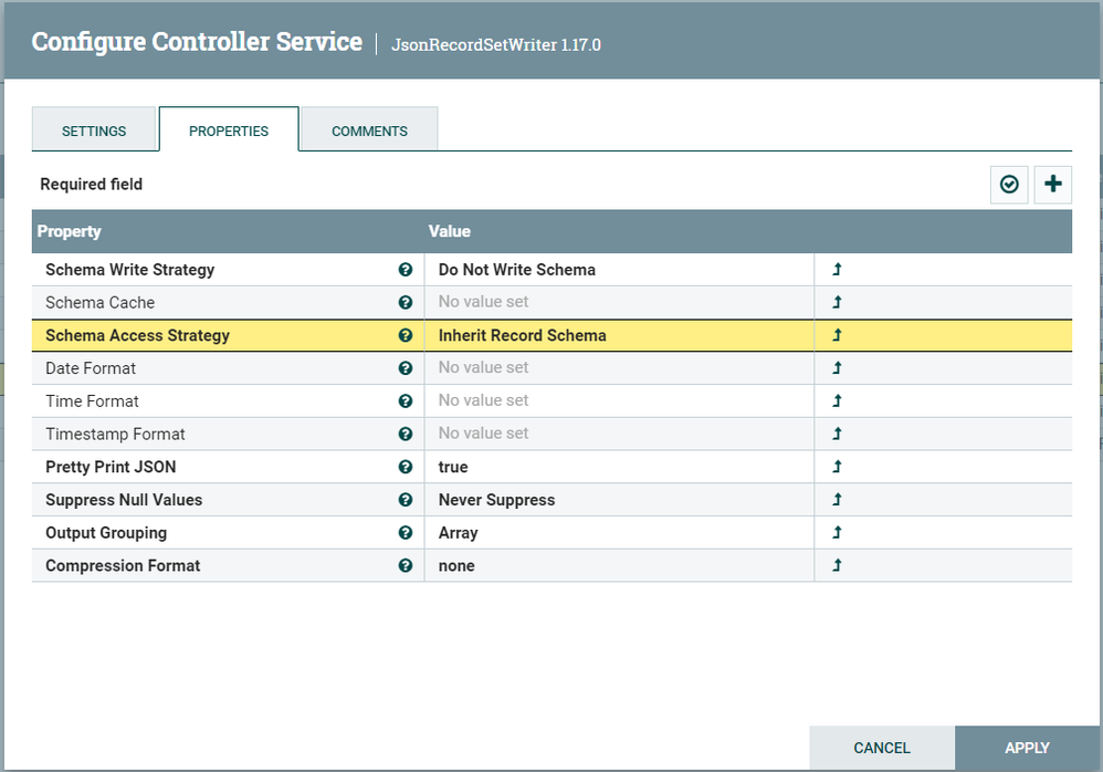

Also, I have configured the JsonRecortSetWriter with the following properties:

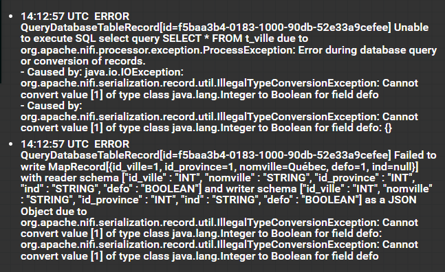

When I run the process, I get the following error:

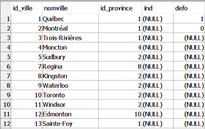

The problem is that values in the boolean field "defo" in the table are considered as integer rather than boolean. Here is a caption from the table I want to convert:
