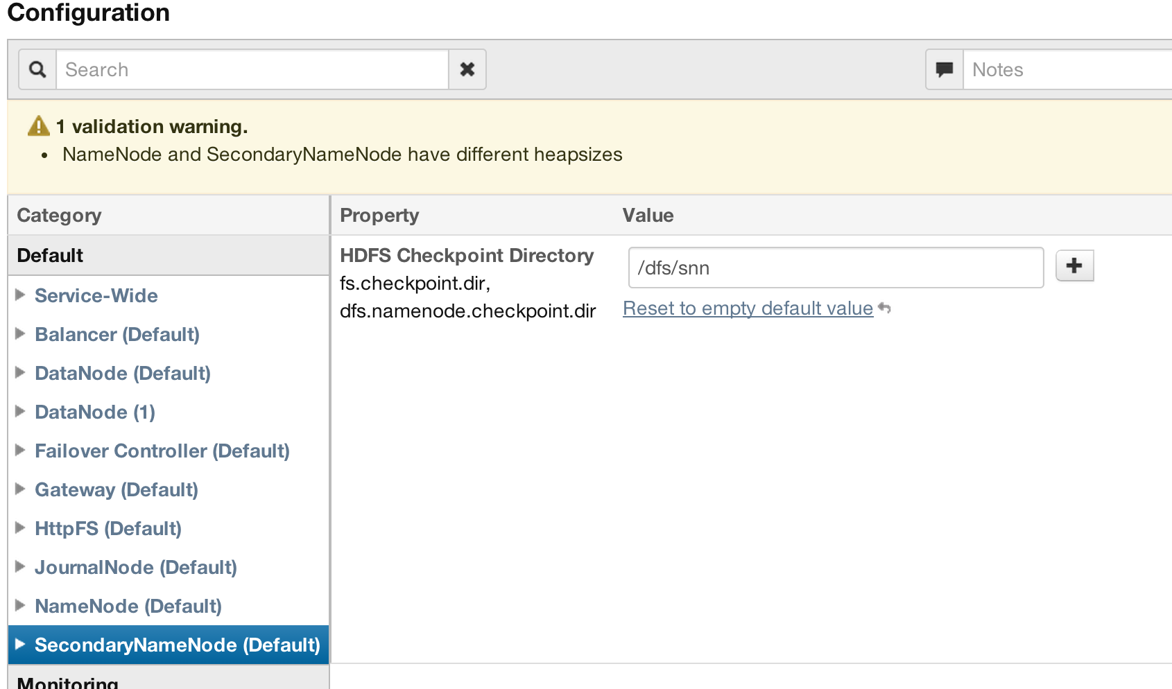

Thanks, but none of those bring up the heap space parameter.
The only config option i get for secondary name node is:
"HDFS Checkpoint Directory"
Weird.
Is there perhaps a link i can use within CM to get to these settings?
Thanks
It looks like you tried to put up a picture, but it isn't displaying.
Did you try using the search box on the left?
I'm guessing you are just not clicking in the right group / category on the left, or not using the search box.

ohhhh the search box on the left Smiley Happy
I missed that somehow. Thanks very much!
