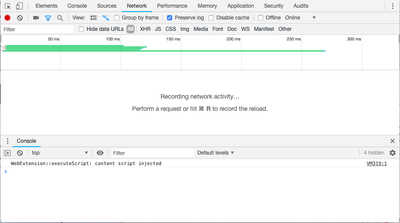

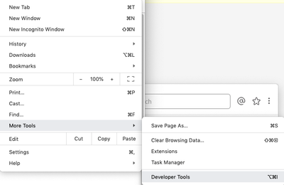

While focused on tab where NiFi UI is open, launch the developers tools.
Chrome Browser example:

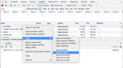

Then perform the action via the NiFi UI and you will see the "Network" call display in list.
You can right click on that call and select "Copy as curl".
Now you have an example of how to execute that same request via command line.
