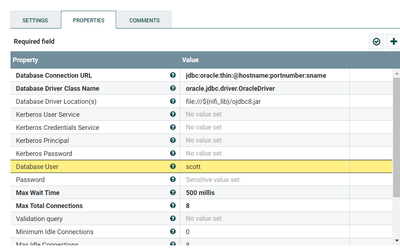

Hi @SAMSAL , i did same configuration but my processor is stuck. am I doing something wrong?
the error I am getting is:
Cannot create PoolableConnectionFactory (IO Error: The Network Adapter could not establish the connection)
- Caused by: java.sql.SQLException: Cannot create PoolableConnectionFactory (IO Error: The Network Adapter could not establish the connection)
- Caused by: java.sql.SQLRecoverableException: IO Error: The Network Adapter could not establish the connection
- Caused by: oracle.net.ns.NetException: The Network Adapter could not establish the connection

Given what you have shared in this thread, I would recommend that you begin by talking to your DBA or perhaps the person that installed the database on the server. The string that you have entered on the properties tab, as shown in your page shot:
jdbc:oracle:thin@hostname:portnumber:sname
…needs to be replaced with the values appropriate for the server where your actual database is installed. To be a bit more specific, you have to get the actual literal values for hostname, portnumber and sname necessary to access your database and enter all of them correctly. In my personal experience, you'd also be much better off if you can verify that the database server is accessible via JDBC using some other tool so you have a way to validate the connection string before you get involved with NiFi-specific details.
