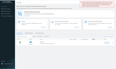

When I try 'Activate' Environment to create virtual datawarehouse of CDW
The error occurred below image.

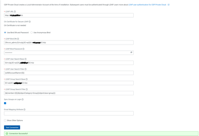

This is Authentication page

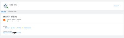

This is environment

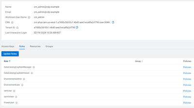

This is role of cm_admin accout
The cm_admin account has all permission on ActiveDirectory.
And all ports related LDAP of Activedirectory server.

I solved this problem.
need por 389 option in LDAP URL.
for example ldap://ad.server.com:389 instead of ldap://ad.server.com
