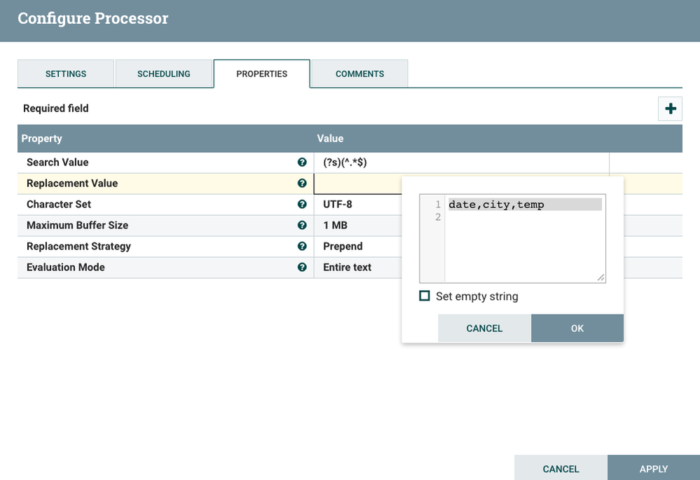

Here is how I have my ReplaceText processor component configured:
I also used "shift+enter" to create a new line at the end of the header being inserted (note that a blank line "2" is shown) and the "Prepend" replacement strategy.

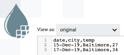

I passed it the following test CSV content:
15-Dec-19,Baltimore,27
17-Dec-19,Baltimore,34
I then listed the queue on the success relationship connection outbound from the ReplaceText processor.  From there I could click on "View Details" icon to far left of my FlowFile in the queue list and then click "VIEW' to see what the resulting content looked like.
Here is what I see for my sample source content above:
I am using Apache NiFi 1.9
