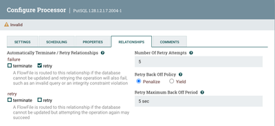

First, enable the retry option on the PutSql or PutdatabaseRacord processors.
If the retries helped previously, this could also help in your case.
Also, decrease the concurrency and batch sizes to try to decrease the SQL load.
