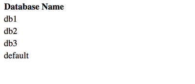

Here is the sample code which may help you.
<html>
  <body>
    <?php
      $conn=odbc_connect('TestODBC','hive','');
 if (!$conn){
    exit("Connection to the database Failed: " . $conn);
 $sql="show databases";
 $resultSet=odbc_exec($conn, $sql);
 if (!$resultSet){
    exit("Error!");}
           echo "<table><tr>";
    echo "<th>Database Name</th>";
    while (odbc_fetch_row($resultSet))
  $dbName=odbc_result($resultSet,"database_name");
  echo "<tr><td>$dbName</td></tr>";
    odbc_close($conn);
    echo "</table>";
 </body>
</html>
Note: I do not have any authentication metod set for Hive, so I have used AuthMEth=2 in my odbc.ini file as below.
[TestODBC]
Description=Hortonworks Hive
Driver=/usr/lib/hive/lib/native/Linux-amd64-64/libhortonworkshiveodbc64.so
Host=HiveServer2Hotname
PORT=10000
schema=default
HiveServerType=2
AuthMech=2
ThriftTransport=0
Below is Sample Output
