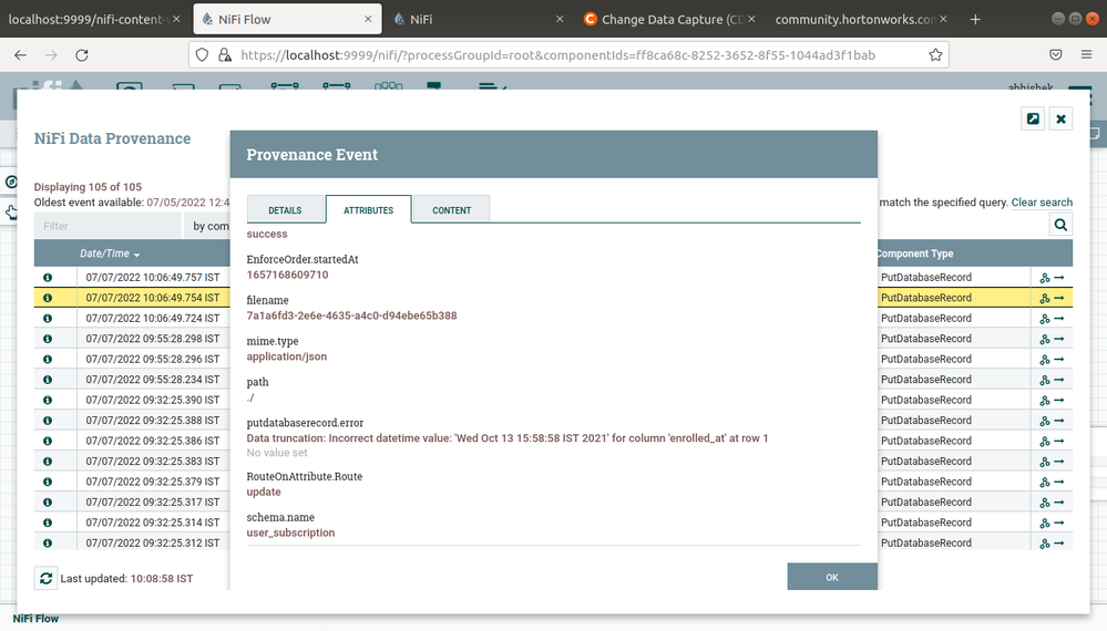

I am getting String Date "Wed Oct 13 15:58:58 IST 2021" in changeCaptureMySql processor flowfile content out claim which is getting read from mysql-bin.log file as source DB data. Destination DB column has datatype DATETIME. I am using the JsonPathReader and AvroSchemaRegistry to read the each column data to save in db but it is giving data incorrect date-time value error.
Q1. Is there any away I can convert String date time value to DATETIME to save it without error?
Q2. How to define the DATETIME data type in AvroSchemaRegistry ?.
I tried below data type in AvroSchemaRegistry but it won't work.
Please find the attached screenshot for reference.

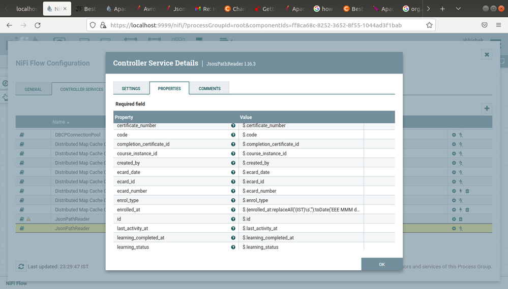

I tried again below expressions:
1. $.{enrolled_at:replaceAll('(IST)\s',''):toDate('EEE MMM dd HH:mm:ss yyyy'):format('yyyy-MM-dd HH:mm:ss')} // got error {enrolled_at:replaceAll does not exist.
2. ${enrolled_at:replaceAll('(IST)\s',''):toDate('EEE MMM dd HH:mm:ss yyyy'):format('yyyy-MM-dd HH:mm:ss')} // expression validation failling
You cant use Expression Language when setting values in the JsonPathReader processor. You need to get the value first as is using the json path  and then use an updateAttribute processor on it using the expression above. In updateAttribute you can use the same variable name or different one.
