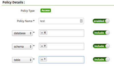

We are creating a new Ranger plugin for Apache HAWQ(incubating) service, which is similar to Postgres DB. We have defined the following resources: DATABASE, SCHEMA, TABLE as a resource hierarchy (schema is a parent of table and database is a parent of schema). All of them are marked as mandatory in service definition JSON, as the same table might exist in different schemas / databases so the parent resource types also serve as a namespace for the leaf types.
This allows us to create a policy such that a user can create any table in a given db/schema (X/Y) by specifying "X" for DATABASE and "Y" for SCHEMA and "*" for TABLE and assign CREATE access-type to the user.
However, how can we define a policy such that a user can create any (or specific) database only ? The Ranger Admin UI requires entries for resource sub-levels (schema and table in this case), so it is not possible to just specify "*" for DATABASE and nothing for schema and table. Removing mandatory designation from SCHEMA / TABLE is not an option either as they are required when working with tables.

Our thinking is that if Ranger <--> HAWQ integration is enabled, all traditional privilege checking inside HAWQ that is managed via GRANT statements will be turned off to allow Ranger to be the single source of truth for authorization decisions. That will require that create/connect/usage operations for databases and schemas are authorized by Ranger as well, hence the need to define policies for resources on all levels of the resource hierarchy.
If we use different permissions (like create-database), which resource will we define it on ? We can't define it on the table level.
One hacky way to achieve what we need is to model database / schema twice -- once as a top-level resource without children so that we can define policies on it and once as a parent to serve as context for children.
There is no restriction on the permissions that can be specified on a specific resource. Following policies can be used for your usecases. Please review.
1. To permit creation of databases named like testdb*: resource: { database=testdb*; schema=*; table=* }; permission: [ create-database ]
2. To permit creation of schemas under database db1: resource: { database=db1; schema=*; table=* }; permission: [ create-schema ]
3. To permit creation of tables under database=db1; schema=schema1: resource: { database=db1; schema=schema1; table=* }; permission: [ create-table ]
New Member
Thank you Mahdan, this seems to be a reasonable workaround in the absence of the core feature.
