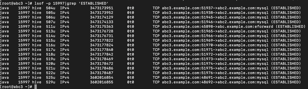

If you are concerned about the number of connections going to Metastore database from the Hive Metastore process, you can use the below way:
1. Find out the PID of HMS process on the server using the below command:
ps -ef | grep -i hivemetastore
2. Once you have the PID, get the put of below command:
lsof -p PID | grep ESTABLISHED
This will give you list of all the connections being made to and by the Hivemetastore process. This will also include the connections made "TO" Hivemetastore process from the clients i.e. from the Hive CLI shells.
Please look for the database type in the output to confirm the connections FROM Hivemetastore to HMS DB.
For example on my side, I have the below output:
In the above photo, all the outputs that have "mysql" in it are being made from HiveMetastore Process to HMS DB.
