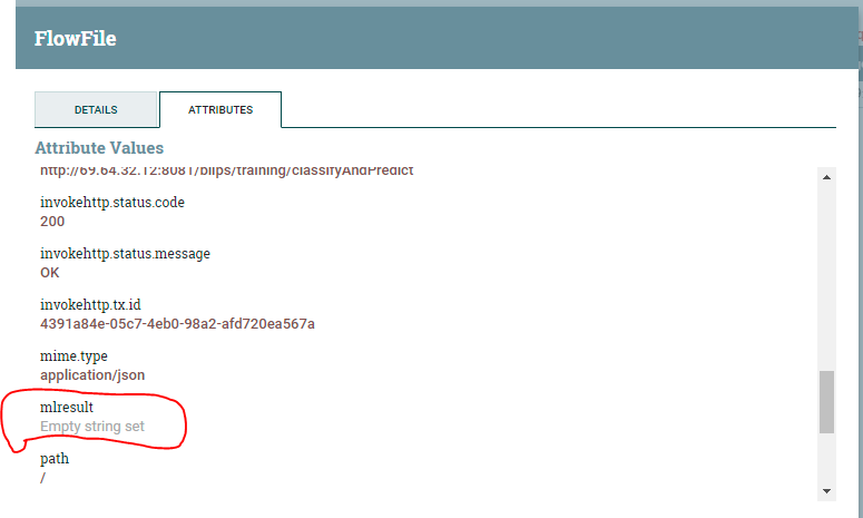

I have json flowfile,  [{"prediction":"Test2"},{"prediction":"Test2"}].
I am want extract the 1st part of the array ie prediction":"Test2  my destination is flowfile-attribute using EvaluateJsonPath .
I have added a custom attribute mlresult --->$.prediction[0], to extract the "Test2" into mlresult, but I am getting empty string  for the mlresults for the flow file attribute section.
flow file : [{"prediction":"Test2"},{"prediction":"Test2"}]
EvaluateJsonPath configuration:
How to get the value(only one)  Test2 to mlresult?

Master Collaborator
@murali2425
Here are two possible solutions.
At solution 1 the value is set into an array.
At solution 2 I took the flowfile-content (json) and set it into an attribute. Then you can work with expression language to get the value.
For testing the syntax I recommend this site:
http://jsonpath.herokuapp.com/
