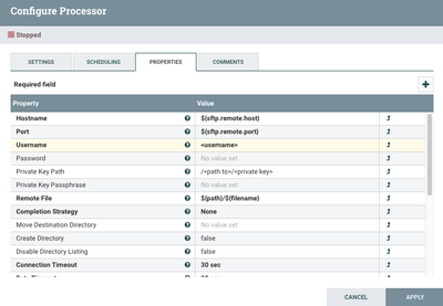

For example, your FetchSFTP may look like this:
You'll see 4 places where I used NEL.  NEL expressions always start with "${" and end with "}".  Above examples are very simple in that they only read the attribute name form the source FlowFile and use the value assigned to that FlowFile Attribute in the processor configuration property.
NOTE: Not all processor properties support NEL.  Floating your cursor over the "?" icon in a property will tell you via popup if NEL is supported by that property.
