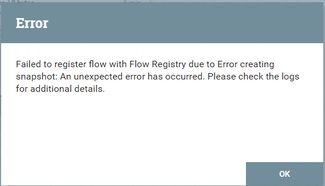

I need help. I trying to version my flows, but is show this error:
(Failed to register flow with Flow Registry due to Error creating snapshot: An unexpected error has occurred. Please check the logs for additional details)
