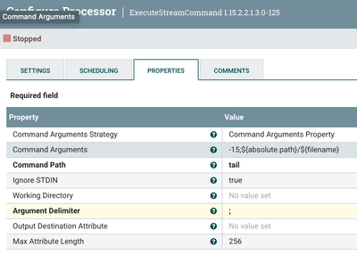

Hi @templarian ,
You can use something like the example below:
Cheers,
André

Super Guru
Hi @templarian ,
Cheers,
André
Was your question answered? Please take some time to click on "Accept as Solution" below this post.

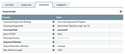

Contributor
Hi André,
That is what I needed. Thanks a lot.
For those who are facing the same problem in windows; @araujo's solution also works with Powershell
