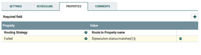

The first solution works! Thanks @Matt Burgess
Here's the RouteOnAttribute configurations.
