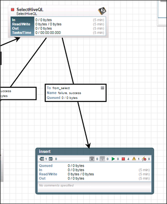

2. After executing the "SelectHiveQL" processor i wanted to insert the data to a different table in Hive. I tried using "PutHiveQL" processor but it doesn't have any field for writing my insert command. So i used the "SelectHiveQL" processor for inserting the data by using "insert select" statement (see attached screenshot) 6737-snap-2016-08-18-at-115333.png

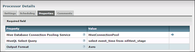

@Constantin Stanca Hi and thank you for replying. Just to be clear - i have two tables: staging and permanent. I want to select from the staging table and insert the results to the permanent table. So i created a process group with SelectHiveQL processor that queries a specific column (event_time)
In that process group i created a sub process group for the insert process.

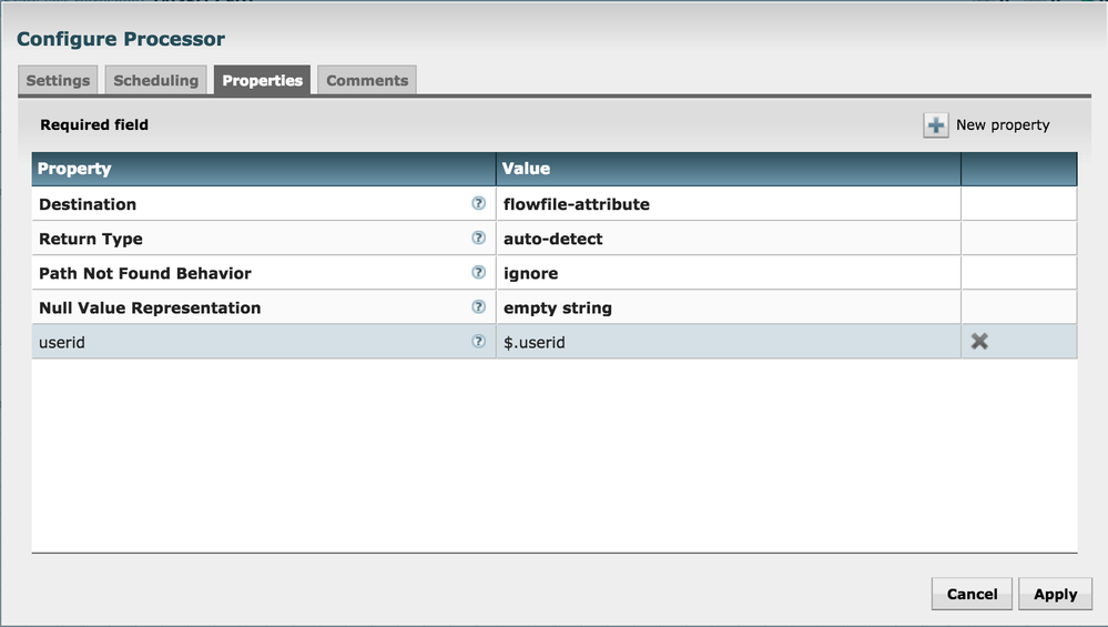

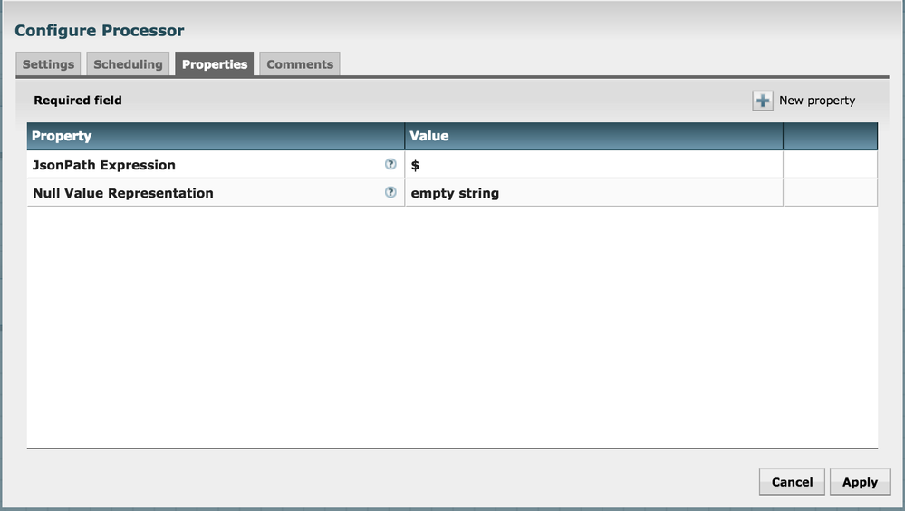

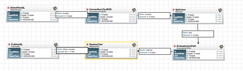

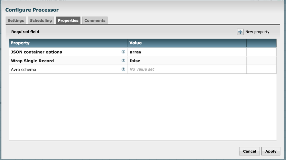

@Adi Jabkowsky You are trying to convert Avro data directly to text. You need to first convert Avro to a text format and then extract text value before using ReplacementText processor.
You can use processors pipeline as shown.
1. Convert Avro output to JSON
2. Split JSON to handle multiple lines from output.
3. Use EvaluateJSON processor to get individual column from output and set it to attributes in flowfile.
4. Use ReplacementText processor to generate an insert statement and then use putHiveQL processor.
Other option is to generate output in CSV format and then use regular expression to read column values.
