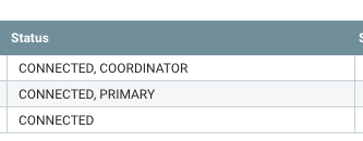

What are the reasons being given in the NiFi elected cluster coordinator nifi-app.log for the disconnection or from the disconnected node's nifi-app.log?
No matter which NiFi node you are connected to any, change request must be sent the elected "Cluster Coordinator" that replicates that request to all connected nodes.   If any of the nodes that has been requested to make the change fails to respond in the node will get disconnected.  The elected "Primary node" is the node on which any primary only scheduled processor components will run. It is also important to understand that which node is elected as the "Primary" or "Coordinator" can change at any time.
I don't think forcing all your users on to the Primary node is going to solve your issue.

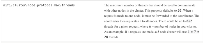

You should also be looking at things like CPU load average, Heap usage, and Garbage collection stats on your primary node versus the other nodes.
Perhaps adjust max timer driven thread pool sizes or adjusting timeouts would be helpful.
Cluster Node Properties
