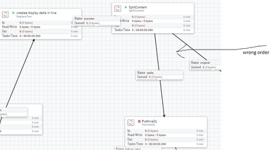

I am generating my hql dynamically, but PutHiveQL can only executing one statement at the time so i have to split my hql op in separate flowfiles.

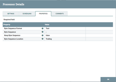

I do that by splitting following hql code on semicolon which gives my every hql step in each flowfile which i direct to PutHiveQL processor
My problem is that it does not sorts it in the order original hql steps was written.
It tries to create the table1_t2 before it tries to create table1_his and errors out.
Can i do something to make sure that my hql flowfiles comes in the right order ?.

part of flow
SpliContent Configuration

What version of NiFi/HDF are you using? As of NiFi 1.2.0 or HDF 3.0.0, PutHiveQL supports multiple statements (via NIFI-3031) and there is also an EnforceOrder processor (via NIFI-3414), the latter of which could be configured to use the fragment.index attribute for the Order Attribute property and ${fragment.identifier} for the Group Identifier property.
Prior to NiFi 1.2.0, you can try adding an UpdateAttribute processor between SplitContent and PutHiveQL, setting the "priority" attribute to ${fragment.index}. Then use a PriorityAttributePrioritizer on the connections between the SplitContent -> UpdateAttribute -> PutHiveQL. I'm not sure if this works as-is because the documentation suggests the priority comparator is lexicographical and not numeric. If that's the case, you'd need some Expression Language functions or an ExecuteScript processor to left-pad the fragment.index values with zeros to make them all the same length.

Hi Matt, We are running HDF-2.1.2 planning to upgrade ASAP thanks for your anwser
