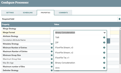

the above approach is correct merge content processor won't support merge format as orc,we still needs to merge all the avro files into one then feed it into AvroToOrc processor.
Supported Merge Formats in NiFi:
