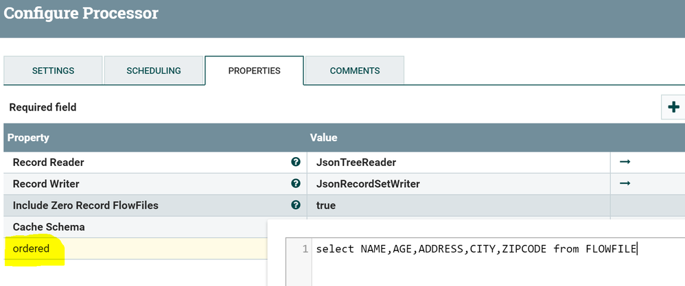

You can do this in NiFi by using Record oriented processors (ConvertRecord).
Using Convert Record processor:
input json:
CITY: "yyy",
AGE:"00",
ZIPCODE: "12345",
ADDRESS: " "}
Use ConvertRecord processor with Json Tree reader as controller service and give your matching avro schema and enable controller service.

By using the configured reader convertRecord processor is able to read your incoming data.
To write in json format configure/enable JsonRecordSetWriter controller service and give the matching avro schema(change the order of the fields while writing)
AvroSchema:
"namespace": "nifi",
"name": "balances",
"type": "record",
"fields": [
{"name": "NAME", "type": ["null", "string"]},
{"name": "AGE", "type": ["null", "string"]},
{"name": "ADDRESS", "type": ["null", "string"]},
{"name": "CITY", "type": ["null", "string"]},
{"name": "ZIPCODE", "type": ["null", "string"]}
Now while writing the output data processor writes with the matching avro schema with ordering the fields in same way
Output:
[{"NAME":"xxx","AGE":"00","ADDRESS":" ","CITY":"yyy","ZIPCODE":"12345"}]
