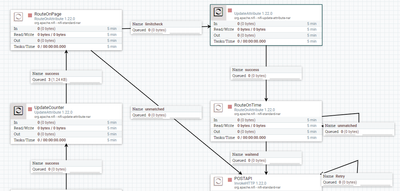

I have a template to do a post method using InvokeHTTP, there can be many number of post requests so, I want to pause the execution for 5 minutes after every 1000 flowfiles. Is it possible to get the count of flowfiles processed?
I tried creating a counter, but sadly I couldn't come up with a logic to increase the count.
 I do not have any release signal identifier to use Wait processor.
please advise. Thanks in advance

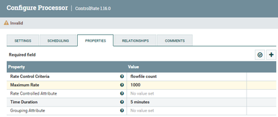

In your case the processor configuration would be something like this:
If that helps please accept solution.
