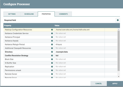

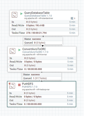

Hi I can read data from sqlserver. Converted it into ORC and now trying to push it into HDFS.
My PutHDFS config are below.
I'm just putting data into hdfs to PutHDFS is terminated at success. Can you guys please help me get past the error below

please check here for the config of the putHDFS processor to write to Azure: https://community.hortonworks.com/content/kbentry/71916/connecting-to-azure-data-lake-from-a-nifi-da...
New Member
@Harald Berghoff I will try this and try to push data into HDFS. I'll update . Thanks
New Member
@Harald Berghoff I tried the steps in the article. But I'm getting the same error. I was hoping that this would atleast change the error but it didn't . Any suggestions?
New Member
The solution provided by @Harald via link is good enough as a solution. The only prequesite is that the cluster should be on top of Azure Data Lake and not azure datastorage. If its a cluster then solution should be replicated on all nodes. If it's only Edge node then solution should only be applied only edge node. By solution I mean the solution in https://community.hortonworks.com/content/kbentry/71916/connecting-to-azure-data-lake-from-a-nifi-da.... Thanks
