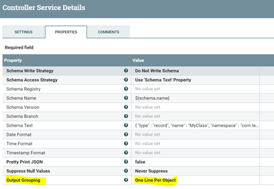

In NiFi-1.7+ you can write one line per object i.e
If your desired output is like one line per object then use Merge Content processor with delimiter strategy as text then demarcator as shift+enter, then you will achieve the same output flowfile one line per object.
