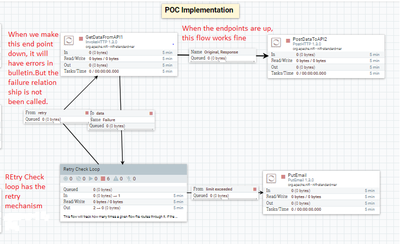

Hi Everyone,
I am using invokeHTTP Processor. When I down the server, the flow is not going to failure mechanism. I want to retry the connection when the server goes down. So I wrote my retry mechanism under failure relationship. But the failure flow is not trigerred, instead it gives the error in the bulletin(when the retry mechanism is failed after the configured number of times, I can refer this bulletin and display the error to user. But for now I want to implement the retry mechanism). Can someone help me out with this case/scenario. Please find the attachment files.

@Dhamotharan P
It looks like your flow is never triggered. InvokeHTTP is waiting for an incoming flow file that will be added to the body of your http call. Add a GenerateFlowFile before your invoke just to trigger it. You should see flow files going to failure relationship.
Can you test that ?

@Dhamotharan P
Can you test that ?
