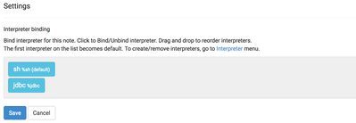

I am using HDP 2.5 and zeppelin 0.6.2. I saw that support for standalone python interpreter was added in zeppelin 0.6. How can I use this functionality when running zeppelin with HDP. I am unable to create the python interpreter using the sh interpreter group. Here is my list of available interpreters:

python interpreter is not installed in HDP by default, you need to install it by yourself.
https://zeppelin.apache.org/docs/0.8.0-SNAPSHOT/manual/interpreterinstallation.html

I am not able to find the python interpreter in my list of interpreters. So, I would need to create one. Can you tell me the interpreter group with which to create the interpreter? I have edited the question, so you can see the list of available interpreters. Thanks

@Nilay Jain, in this case you will need to add python interpreter. Refer to below link to add python interpreter in zeppelin
https://community.hortonworks.com/questions/77411/python-interpreter-not-configured-in-zeppelin-on-h...

I installed the python interpreter and now everything works fine. Thank You.
