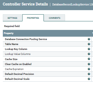

Hello
I'm using Postgresql with NIFI, how can I specify the schema I want to use from Postgresql
There is no option for the schema in the DBCPConnectionPoll.
and there is no option for schema also in the lookup service

Thank you all for your replays, The fix was so simple:
All I need to do to specify from which database schema I want to work with or have the lookup service connected to I just added the schema name before the table name like this :
sandbox_s01.table_name

p>Hi @FediMannoubi I want to add a bit here and add on to what @ckumar wrote earlier in the thread.
What tool did you capture the first screen shot from? Does that tool connect to the Postgresql database server via JDBC and using this Database Connection URL?
jdbc:postgresql://127.0.0.1:5432/ATL2
I ask because if you had, that would validate that the connection string you are using is indeed valid. I strongly recommend that you carefully read the documentation for Connecting to the Database, as it has detailed information on how a valid JDBC connection string should be formed. Comparing the available forms described on that page, and comparing the options to the string that you have captured in your page shot, the relevant option for the PostgreSQL JDBC string in this case appears to me at least to be the following form:
jdbc:postgresql://host:port/database
If the string you've already entered into the Database Connection URL property works, then you can proceed assuming that the final characters are the "database" and so in your case the database would be ATL2 The first screen shot appears to indicate that the database is named rei. I don't know what to make of that difference.
