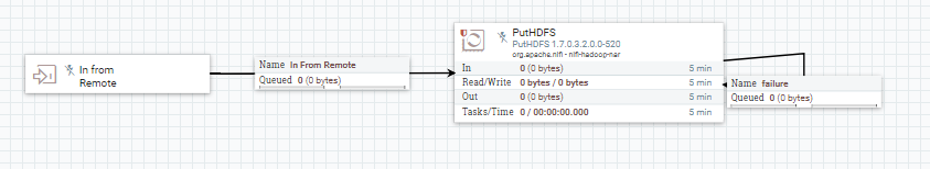

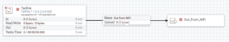

I am planning to implement this use case pushing tail output from NiFi (HDF) to MiniFi to HDFS (i.e. HDP). I attempted as per your suggestions, however there are errors and looks like the input port in MiniFi would require. Below is the error & attached the error + ports info
I have 2 clusters, one for NiFi (HDF 3.2) & another HDP 2.6.5
"'Input Ports' in section 'top level' because must be empty in root group as external input/output ports are currently unsupported"
Am I missing something? Kindly guide.
