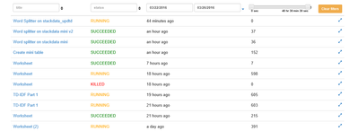

Hi all,
I have been using Hive on Sandbox for the past few days. It was working fine up until yesterday when I noticed that my queries were taking an unusually long time to run or, more annoyingly, not running at all.
On further investigation, I checked the 'History' tab and noticed that there are a large number of queries which are still running.
I have been trying to terminate/kill the sessions without success (It will say "stopping" but never turns to killed). I have also tried rebooting and redeploying my VM.
Does anyone know how I can stop all running processes in Hive?
Thanks in advance.

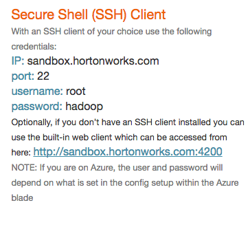

Hi Artem - Apologies as this question might seem elementary but I am very new to Sandbox. Where can I access the terminal? Thank you.
Highlighted
Re: How to shut down/kill all queries in Hive
Mentor
No apologies necessary, you've come to the right place. You need to open a shell to the sandbox either with an app like putty on windows or terminal on Mac. Then you need to type the following, it will ask for your password, password is hadoop, enter, same password again, then new password twice. When you are logged in you can execute yarn commands
ssh -P 2222 root@127.0.0.1
Highlighted
Thanks for the quick response. I am going to use putty to ssh in - so is it correct to type into the Host Name on putty: my public DNS for sandbox:8080.
I have done that and logged in as root when prompted and then entered "hadoop" as the password. I am now getting an access denied message.
Any ideas? Thanks!

@Maeve Ryan Try using root@sandbox.hortonworks.com -p 2222. You can also try port 4200 from a browser.
